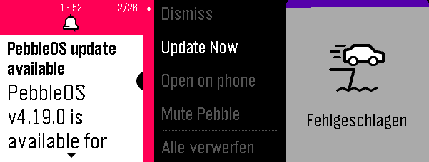

Update: Factory Reset also only gets the watch to 4.17.0. On the plus side, Factory reset is fairly painless and quick. (unless you have something stored for the apps I presume, which I don’t)
I just tried to trigger the update (via the notification on the watch) and got the message “Failed.”
I can’t upload any pictures yet, so here’s a link:
clock screenshot (But the link is only valid for one month)
